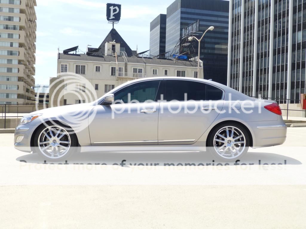

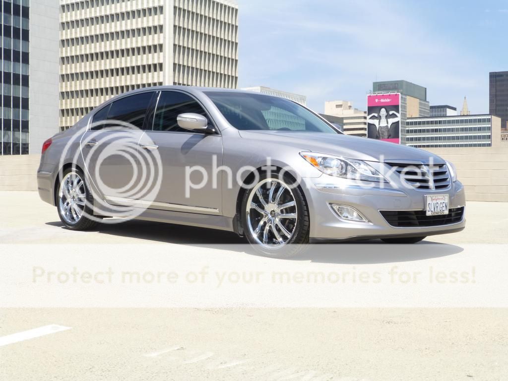

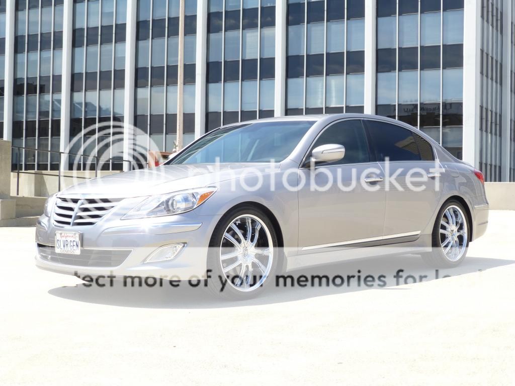

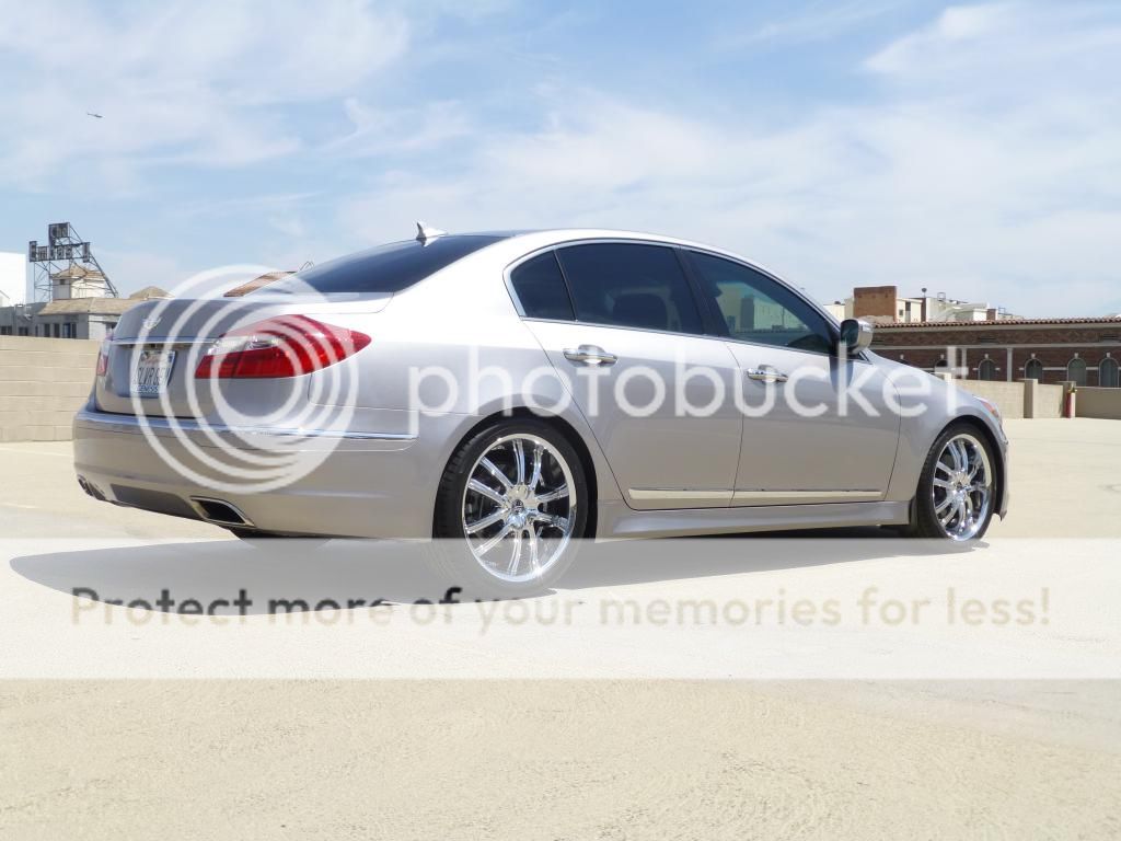

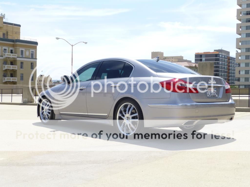

Bought the wheels last summer, tested them out 6 months ago; had fitment issues in the front because of the calipers; finally got that resolved a week ago and purchased tires. End result!

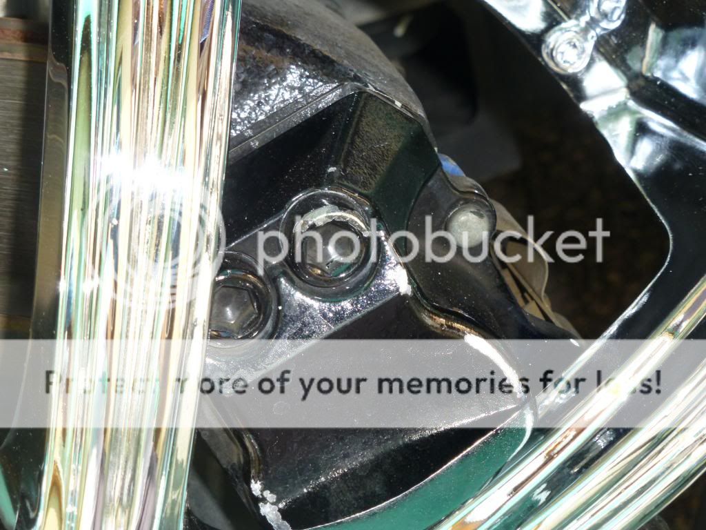

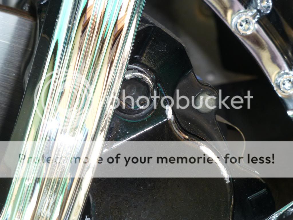

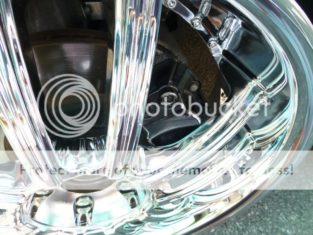

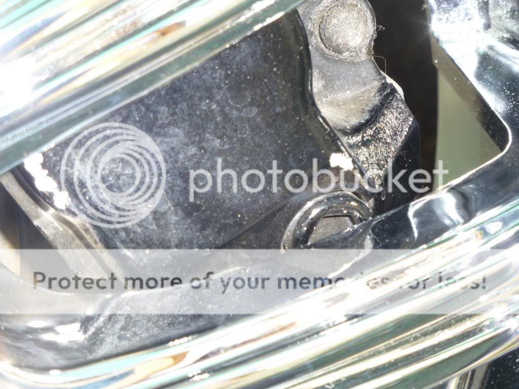

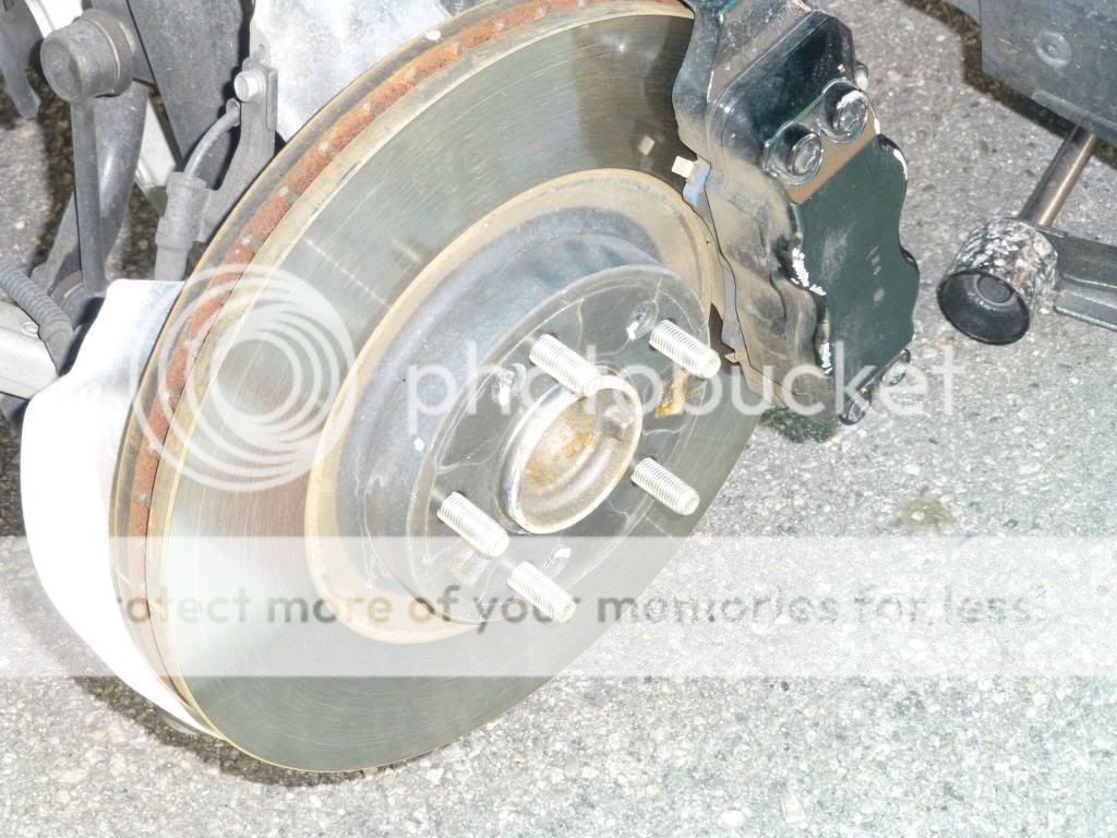

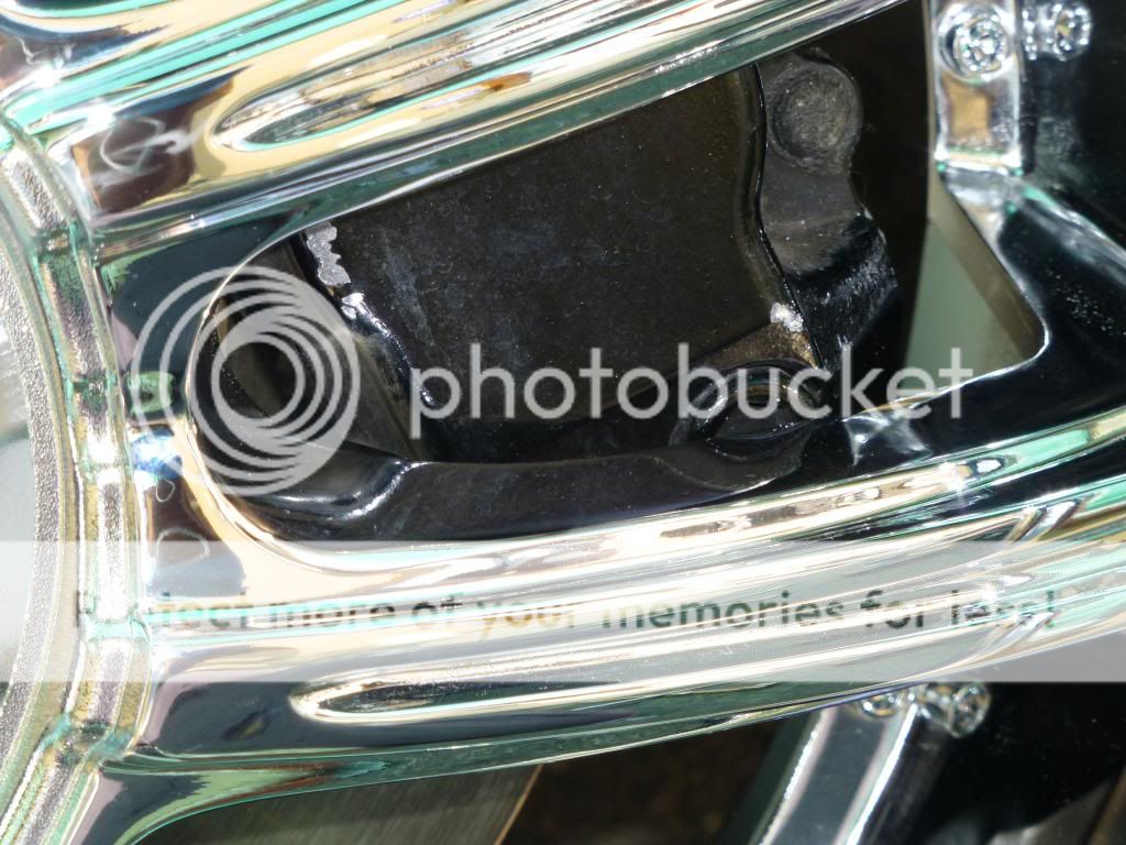

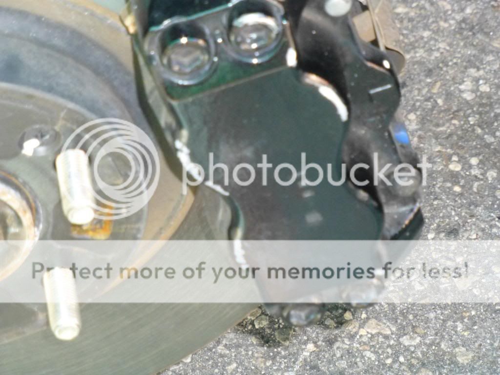

The fitment issue was with the wheels fitting over the front calipers. The rears fit fine, no problem, but when tightened down all the way, the wheels on the front would not spin because they were hitting the caliper. I think the sedan calipers are even thicker than the Brembo coupe calipers. Ultimately some very thin spacers solved the problem (and I need to do a little paint job on that one caliper, lol)!

Xiaphin, rim size is 20 X 8 with 40 offset. I don't really understand the whole offset thing, but the manager at the place where I had them mounted and balanced said the offset should be 35 or lower to fit over that front caliper. Tires are Hankook Ventus V12 evo 2 K120's, 245 40 20. I had originally ordered 255 45 20, but the tire shop was great! They contacted me prior to the sale and told me they wouldn't fit; too wide, would rub, so switched to the "smaller" size (and also saved $10 per tire)!
I was very hesitant to go any lower than 40 because I wanted some meat on the tire to protect the rims in case of pot holes etc.

Chewbakorox, thanks for asking. Prior two posts should help; and yes spacers solved the problem, but very thin ones; 1/8 in. which is 3.75 mm. Any other questions, just let me know; glad to answer! :D
