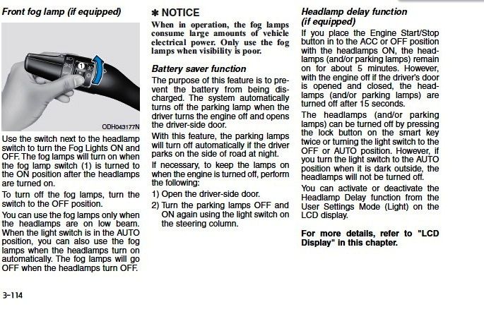

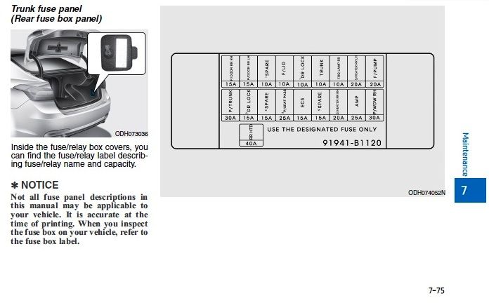

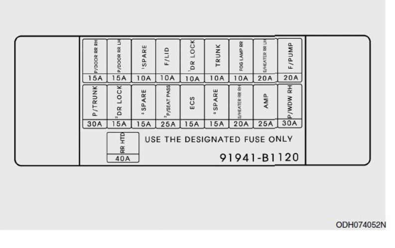

Here you go. It is located in the trunk. Be sure to read the warning below in the 3rd snap shot from the manual. "The Fog lamps consume large amounts of vehicle electrical power. Only use the fog lamps when visibility is poor"
I believe that that fuse is for the non US versions that have rear fog lamps.
