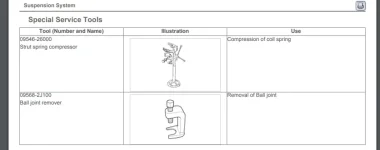

Old thread, but did anyone have luck getting that ball joint out? Looking at AllData and I can't find anything about this ball joint. Will just have to get creative with removing it I suppose.
There is a tool. Part# 09568-2J100
I imagine any similar gear puller will work.
It looks like
It looks like that tool is for the forward control arm/tension arm that has the ball joint already pressed in. That remover won't do anything for the bigger ball joint that's pressed into the knuckle and connects to the other control arm.
1) remove wheel hub bearing from knuckles.
2) remove knuckles from car
3) remove C spring from the ball joint bottom
4) use fire heat gun to heat knuckle
5) use big hammer to remove ball joint from knuckle
6) use benz "C type ball joint installer" to install ball joint.
example video
at 3:39
at 2:20
