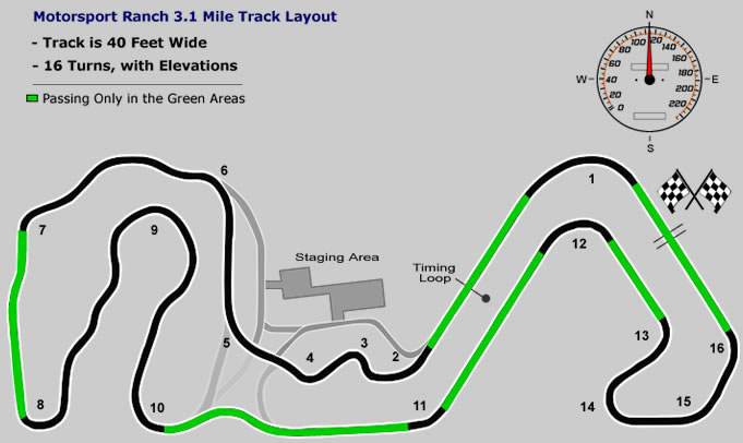

I just came back from Track Day at Motorsport Rank at Cresson. We didn't get to run the G70 because of a cracked windshield. I was a bit miffed because I had emailed the organizers 10 days before the event asking for clarification on what qualifies as "severe crack". Even sent them pics of the windshield. I was originally told it would be okay to run. Then, just before the weekend, I was told the safety steward advised against running for safety reason. WTF?! I probably could've gotten the windshield replaced in time for the event, if they had told me that upfront. Urghh...
Anyhow, on the bright side, EBC Bluestuff performed brilliantly on the Stinger. The 3.1 mile course has several WOT straights that got the car up to speed, which then had to be scrubbed off. My geriatric brain couldn't learn all the corners faster enough, so I didn't threshold brake much until later in the afternoon sessions. Still, the brakes got plenty hot. Brake modulation was uniformly linear and responsive from start of session (cold) to end (hot). Never a hint of fade. ZERO brake pad material transfer.
The downside...
1. The front brakes pads have pretty much worn off the bevel. I didn't measure the bevel thickness when the pads were brand new, but it is a substantial amount. I would not be surprised if they are down to 1/2 worn by the end of next Track Day event in Nov.
2. Brake dust production is prodigious. It's looking like I'd have to clean the wheels at least once, if not twice, a week of everyday driving.
3. After final bedding in at the track, I noticed a bit more hissing, but not all the time. Not at all objectionable, certainly not from inside the cabin with windows closed.
Would I recommend them? Yes, if you plan on running your car hard on race track for longish sessions. If you AutoX only, they are way overkill. Yellowstuff would likely be more than plenty and might even be okay for occasional track duty, particular on short technical tracks. I might try that next.
