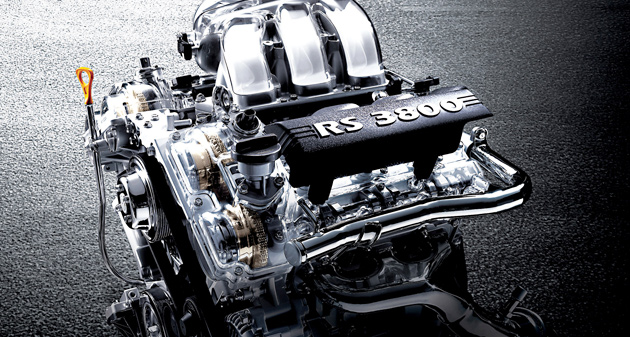

No, the all-aluminum Coupe V6 was redesigned from the start, partly to fit under the lower hood. The Lambda was redesigned as the "RS Lambda" (or RS 3800). During the years up to 2012 it was port-injected, then in 2013 it was changed to GDi, basically just a change in heads and intake config, perhaps pistons. Much of that power increase is due to the higher compression and testing on regular vs premium, not the trendy GDi (which only creates more issues with needing better fuels). The Sedan's 3.8 is an obviously similar yet somehow different engine with slightly less power. The Sedans got the GDi upgrades before the Coupes, but the Sedans still had less power, not to mention more weight. Thus entered the lovely 5.0 R-Spec ;)
Here's an article from the time:
http://www.motorauthority.com/news/1023283_hyundai-develops-high-performance-rs-lambda-v6
"Hyundai is pulling out all the stops for its upcoming Genesis Coupe, already confirming the car will ship with Brembo brakes and now with a newly developed high-performance V6 engine as well. Based on the Lambda V6 family first introduced in 2004, the new mill has been given a number of modifications to improve its smoothness, power delivery and efficiency.
"Cars on sale in the United States will feature a 310hp (231kW) version of the engine with 266lb-ft (360Nm) of torque. Picking up ‘RS’ specification (Rear wheel drive Sports), the new engine not only produces more power and torque than the previous 3.8L Lambda, it also delivers higher torque levels across the rev-range and delivers its peak output figures at lower rpms."
Incidentally, while it is "fighting words" controversial among the turbo guys, the 2.0T in the Coupes is almost identical to the one found in the Sonata and other cars. The head was re-cast as a mirror image in order to flow in the opposite direction in moving from transverse mount to RWD, but 2.0T fans claim the two engines are somehow totally different, yet the brake HP figures are exactly the same. This created the "tuner" market in the Coupes which I believe challenged the car's long-term popularity with non-tuners. Little wonder they've discontinued the 4cyl and now there is only a V6 option. However, the US market has been BEGGING for the 5.0 R-Spec engine to be adapted to the Coupe.
Thanks for the detail. Very helpful... I tend to be biased for V8s.. With that said, the RS version sounds cool and should be in the sedans. They need whatever weight reduction possible. And use this in TT mode instead of 3.3 for the steam rolling lemming moves to replace the TAU with a TT V6. This might get 525hp easy. That might get me interested. IF it was truly lighter by 150lbs or so with all the plumbing a TT would need up front too.
This RS version should be the standard motor for the sedans and coupes?
