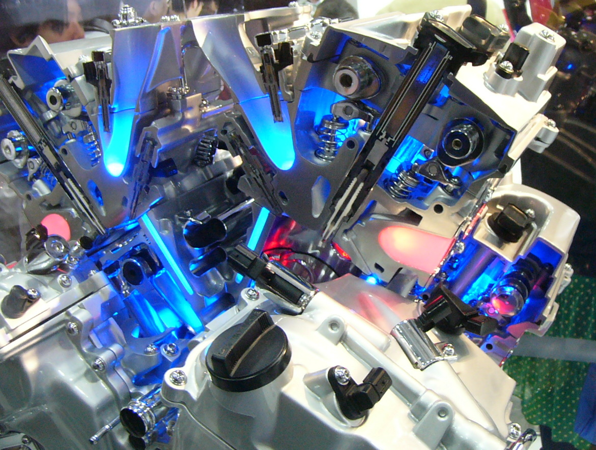

but Toyota's dual injection system D-4S is not just for carbon buildup purpose. But it actually improves power, economy & emissions performance;^ This subject is in other threads under "carbon buildup", as well as hundreds or even thousands of hits online. As virtually all manufacturers are changing to DI, they will all have to have solutions before it costs them too much in warranty costs or bad will with customers. Some have already, such as Toyota with its extra intake port. Others have made adjustments with variable valve timing. Active removal using abrasion (walnut shell particles, etc.) is the only way to completely clean intake valves. That also requires know-how, the right equipment, and the time to expose the valves - and not less than $500.
