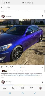

I have 20x9 +25 front 20x10 + 40 lowered on storm springs which are about to be available for sale as I bought brand new customized DS series bc coilovers. About to be like an inch lower in the rear maybe 2 in the front. soorrrry I don't have that many pictures of fitment on this phone..

The guy asking about the 305s is not the OP. I'm assuming he knows that I'm talking about running a 305 on a 20in wheel..
and no 265/35 front 305/30 rear is same diameter as OEM and the most optimal size(this is the biggest I would go anything more and you're gonna have a plethora of issues.. now for 305 a 10.5 or 11 is more ideal 20x10 wheel is the absolute bare minimum size you're ever put a tire this size on otherwise performance starts to be sacrificed
