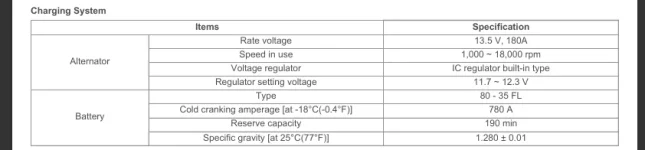

You don't want an AGM battery in a 1st generation Genesis. The charging system is setup for flooded cell batteries and will overcharge an AGM, shortening it's life to that of a typical flooded cell battery, or worse.
So get a group 48H flooded cell with 780 CCA and 190min reserve capacity (V8 spec). Otherwise you're just wasting your money.
Dammmit lol :( ........is my 2012 considered 1st gen? I already put one in......This is the first I am hearing btw as all the prior discussion was around the AGM....
Shahhere
Yes, model years 2009 through 2014 are 1st generation. Also says so in the forum title ;-)
Welp, in another 6 or so years you can switch back :cool:
