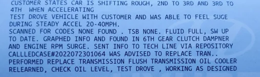

Issue was resolved by genesis dealer as it was still under warranty 5000 miles from void. Replaced the transmission.
