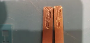

Okay.. I'm going to try a locksmith. These keys a pretty close. One sent from Genesis and the other out of the fob. I'm hoping they can put it in cutting machine and make it work.
Just be prepared that not all locksmiths can do it. The problem is/was the size of the key was too small for the typical locksmith equipment. When this first came up on the forums in 2014, there were only a couple of locksmiths in the country who could do it. One was in Garland and I want to say the other one was in Western New York. I ended up making a round trip to Dallas from Austin to do it; I chose a day when I had meetings most of the day anyway, and just conducted them all from my car 😁.

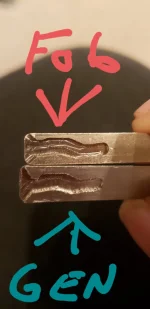

Here is the problem, I got mine to work by doing this.
The key in the smart key is too long, the end of it has a few mm more metal than the fob key,
I used a grinder and CAREFULLY ground it down until it worked in the door, trunk, and glovebox.
Look at your image:
see the tip of the smart card key:
see what i did to mine:
