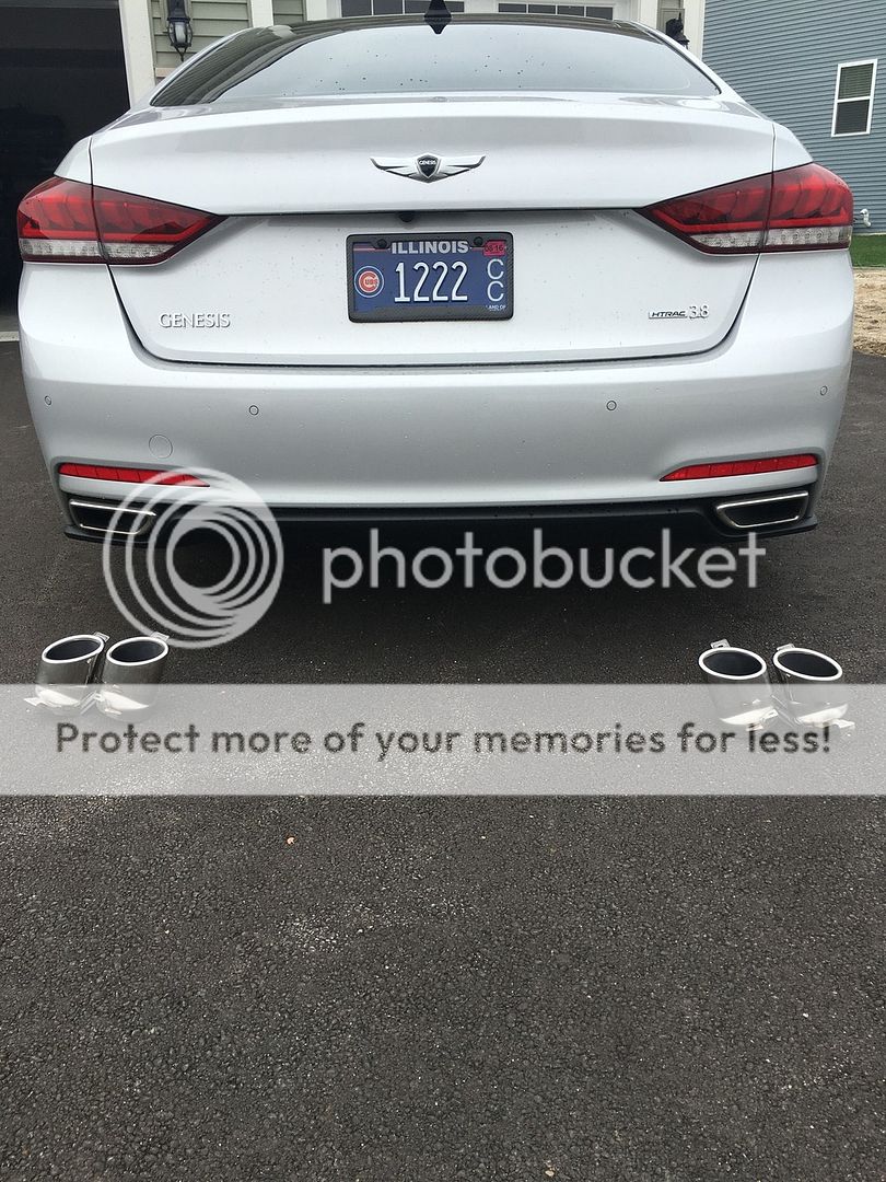

Got home today and these were in the mail 😁 I am going to cut and weld the brackets and fit them up next week. If the tips have no gap in the center they fit the openings on the 3.8 lower valance. Back on the road for work tomorrow again 😕
I'm thinking of fabricating a new rear section exhaust, mostly just for sound.

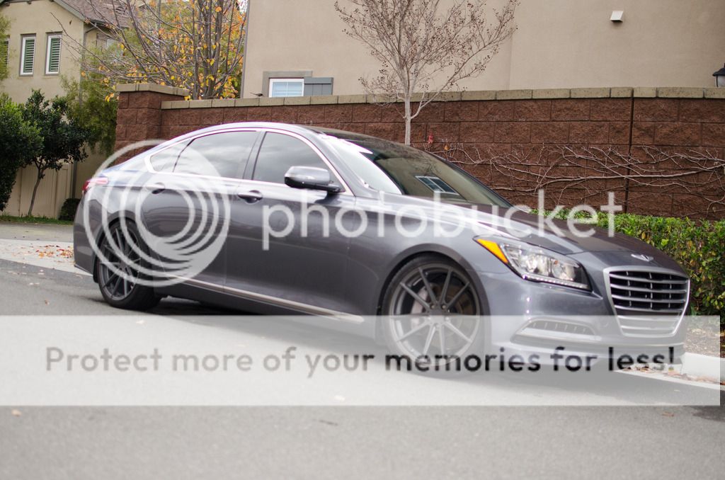

I got my ARK's in today rear sits alot lower than I would like. I like the ride overall.
really would like it sitting a lil higher but what can ya do, we are going though alot of rain so i'll post better pics if requested
[/URL][/IMG]
Damn! rear sits very low, I would say 2 inches lower than OEM springs! something isn't right :eek:
Are you sure they weren't installed backwards? The rear is not supposed to be that low. The front should be lower than the rear. My front wheels are flush and my rear has a 1 finger gap. Your rear is not only flushed but it is TUCKED. The Arks don't do that. At least, not on my car or on others who have lowered on them. I really think something is wrong. Either they are backwards or there is a quality control issue or something.
Fu%k was hoping maybe is was bc I'm awd.. ok back to the shop I go
Look at BoatShoes's car.... I took this photo last week, when I went to visit him, his car sits perfect and it's Htrac as well.
Yea they probably put them on the wrong way.
My car is AWD and measures 26-1/2" ground to fender in front and 26-5/8" in the rear. On the ARK springs.
Thank you for posting that I was just coming on to ask to get a verification of that
I just jacked up the car to take a look myself, based off your ID the front are indeed on the rear
Does the plastic inserts face up or down when they're installed are installed in the front, right now they are on the bottom
