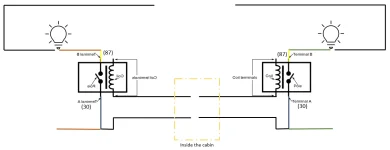

8) Next, add a butt splice between the relay out put (87) to the headlight harness side wire. Your wiring should look similar to the diagram below:

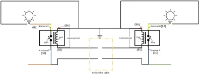

10) Duplicate steps 7-9 with the orange wire and the other pair that comes from the cabin. Your wiring should look like this now:
11) Now you need to tap into the Black ground with some sort of vampire splice or another butt splice and connect both wires from terminal 86 to ground:

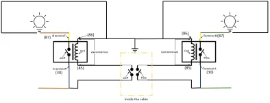

12) Finally, connect each pair of the cabin wires to separate sides of the DPST switch:
13) Now, if you did everything correctly, you should have a secondary means of turning on/off your low beam headlights, leaving you with the ability to run just your swooshes (secondary switch OFF, headlight switch ON) or you can run you swoosh with the fog lights, or you can just run stock by leaving the secondary switch ON. All that's left is to test everything out, mount your new switch somewhere inside you car, perform some cable management and put everything back together!
