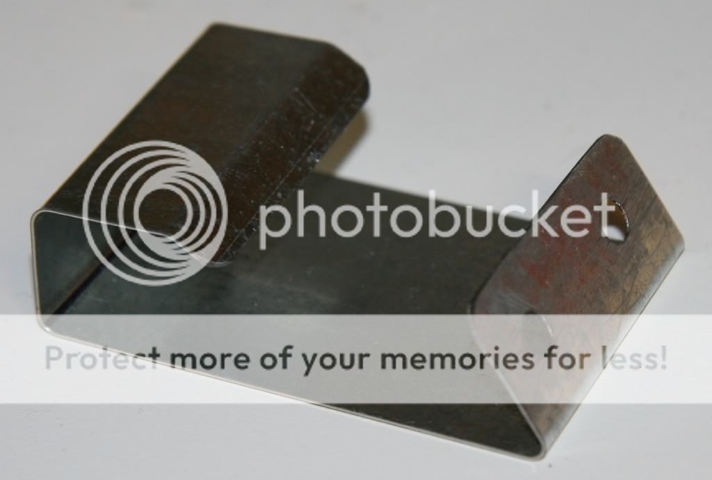

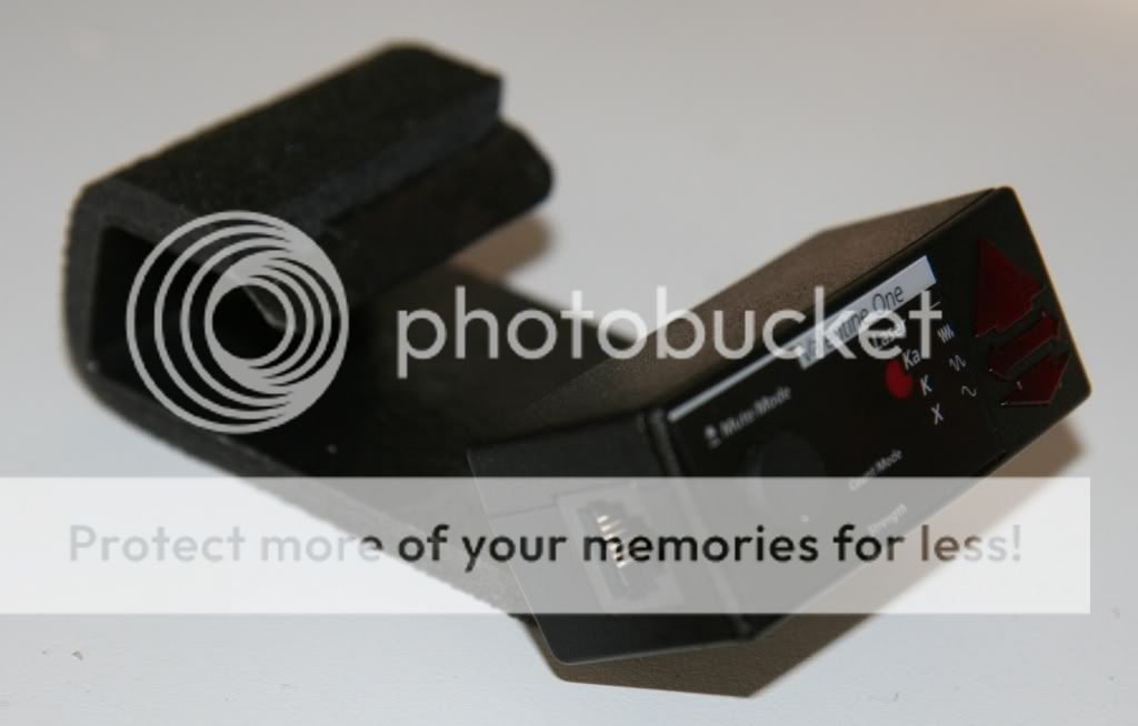

I fabricated a bracket for my concealed Valentine 1 display
Here is the finished painted item with the display mounted and a foam pad to protect the interior of the Genesis
Here is the concealed display mounted in the Genesis. I used the storage slot below the DVD loader.

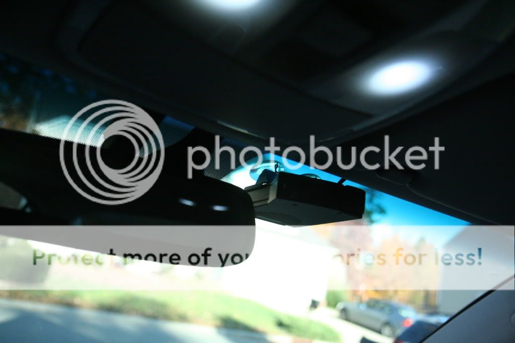

Hi Musher51, Thanks. My main unit is high on the windshield (see photo) similar to how you had previously diescribed your installation. One advantage with the concealed display is that no lights appear on the main unit when the concealed display is plugged in. So this makes the main unit very unnoticable for cars following.
