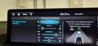

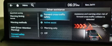

Sorry to drag this up. I found this thread over the weekend and watched the video.
Just wondering how do I tell if I have the front corner radars?
* not sure if the front sensor in the driver assist in the first pic refers to actual front corner radar or ultrasonic sensors
* seems like I do have forward cross traffic safety
* do have smart cruise control with option "based on safety style"
All these at least in the YouTube video wasn't present before the retrofit.
The fact that you have front cross traffic safety is enough to prove that you have HDA 2 which brings along all those goodies. And no, SCC learns from your driving style apparently
