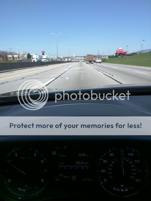

That was like 3 hours into my trip back to Ohio from Atlanta. I actually managed to get just over 28 mpg on my way back(calculated at the pump not the display). Yea it is a 3.8 RWD and I averaged about 75mph.
Thought I recognized I-75 in your pic. Nice! With AWD not sure I'll get close to that, maybe 25 or so, looking forward to a road trip in the Genesis.
