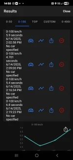

So update 1# i'm very pleased with the performance increase especially at higher speeds However I need bigger tires i tried three times to do a 0-60 launch and i'm i'm doing one wheel peels he fastest time I was able to get was 5.4 out of the three attempts.
2# the car is a lot funnier worse on gas ⛽️ it's kind of more dangerous in the rain more torque and its a open diff lol but it's worth it i would definitely recommend, im getting bigger tires off facebook market place👌 🤣🤣🤣

The gas mileage is trash and if not LSD converted the 0-60 time is the same whether if you start from second or first a whole lot of power wasted lol i'm like, I said, though it does make it faster.Especially at highway speeds i bought a 3.9 LSD to recover some MPG, I'm gonna try selling the 4.18.... i will up date lol
