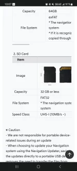

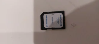

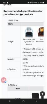

Glad to become a member. Just yesterday I successfully upgraded my nav/software on my 2015 Hyundai Genesis 3.8 (purchased from original owner December '21) to the latest version. WOW what a difference! Since it was just yesterday I still haven't explored all of the differences but I'm so happy I decided to pursue and complete the upgrade. It only took about 45 minutes to complete once I did all of the preliminary stuff on the computer and got the update loaded onto the 32GB SD card. I was hoping it wouldn't take the 3 hours I'd read it could possibly take, and it didn't.
