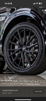

I would imagine that the size of the caliper you can fit would be based on wheel size.
