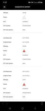

I had the same problem at around 27k they consider it on the app as Powertrain and cost me 0$. I will upload the receipt later. following couple months down the road a new problem occured today at 36k P209600. P008800 was the pump. Car all of a sudden stutted at 40 MPH. Took them about 24 hours to fix. They paid for my Uber ride both ways; from dealership and back. I have 2019 2.0 AWD got it at 3.5k miles - stock 1000000977.webp
here is the recepit for my warranty covered the replacement.20240118_100658.webp
