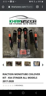

So after finding out i dont have ECE im extremely happy to announce that im going with coilovers.. im ordering the riaction monotube from khartunerz.

Got them in today.. the fronts were easy but the rears were a bit challenging to adjust.. ride quality is good a bit stiff but gotta play with the dampening adjustments
