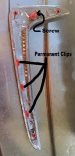

The Next thing I did was manually push on the 3 clips running along the long side of the vent. They are permanent clips maybe 1/4’ wide each. In the photo I have labeled them. Do not press too hard just try to push them over and out gently, however if they break I do not know if it matters since you are replacing it.
Mine did not break, in fact to get the piece off I had to pop it off and no clips broke. I had to because the 3 removable clips labeled 1, 2 and 3 need to be squeezed with pliers and from this angle and tight space it was not possible for me.
So once you have those 3 moved the vent will no longer be against the car so that is part one. There will be enough room to get the clip remover under it and do not worry since the area if scratched is not seen anyway. I did not even get a scratch.
So I carefully pryed on it and the entire vent flew off LOL The reason for the prying is that the 3 removable clips I just could not reach at the right angle with pliers and if they break who cares, the new piece has its own clips.
Clip number 2 on both sides had to be removed afterward with pliers. Not sure why but this is not issue, it just stayed on the car.
Now look at the photos and you will see that the big round clip remains the fender. This is a good thing. Just leave it there.
