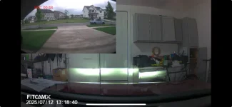

I decided to install both a front and rear dash cam on our 2024 Genesis GV60. The camera comes with a replacement (OEM-like) housing for the rear-view mirror with an embedded camera and a long cord to connect a rear dash camera. I couldn't find any information online on how to install with the rear camera, so I decided to try it myself and document it here to help people in the future!
I was able to do it with minimal tools. It was not very difficult to install overall, and I was able to get it done in a couple of hours in the garage.
I chose to install the rear camera on the bottom rear window and raise the middle head-rest to completely hide the camera when driving.

Ensure that camera is pointing in UP position (there is sticker to show which way; be careful as it can be a bit confusing with the hatch in the air. Cord should go into the right side of the camera when looking at it from below with the hatch open (see picture 2). Use tape or something to tie wire to other wire harness. Make sure you have enough cord (if you measured according to the instructions at the beginning, it should reach). At this point, you can stick camera directly to window in the placement you want (don't worry about the x-axis rotation as the camera can rotate in the housing after sticking to the window. Replace plastic panel and make sure wire is placed in the corner (like photo 4).
