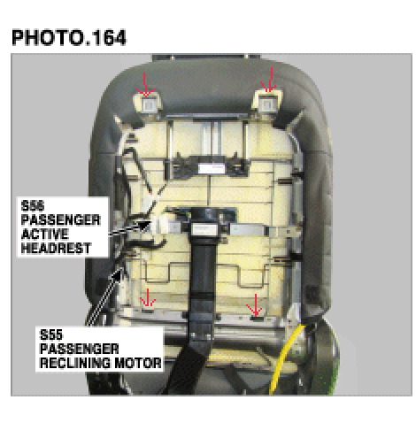

I can't figure out how to release the rear panel of the front seat from the retainer. The online service manual only states to remove the panel with no explanation of how to release the retaining clips. I am in the process of adding additional foam to the passenger seat, that is if I can ever get the panel off.
from the shop manual...

That's the same drawing in the online manual. Step 3 - Remove the seat back panel B. (With no explanation of how to remove the panel) The panel appears to hook in at the bottom with two retainers at the top of the panel. I can't figure out how to release the retainers at the top of the panel. I can see what appears to be a wire sticking out of the retainer but my efforts to push, pull and/or move this wire around has not released the back. Maybe there is some simple way to pop the panel off, but so far it has eluded me.

I have taken mine off and it is not so easy. For the right side of back while sitting in the rear push the plastic back hard to the left then pull. The clips are counter intuitive. After the two clips are disconnected at top it just lifts up and away. I have taken mine off and it is not so easy. For the right side of back while sitting in the rear push the plastic back hard to the left then pull. The clips are counter intuitive. After the two clips are disconnected at top it just lifts up and away.

Finally after a few months, homeofstone has the information on how to remove the seat back plastic cover. Thank you much for this detailed and somewhat elusive & tricky, but proper way to remove the seatback plastic cover. Regards, and Happy Thanks Giving to you. Dan
