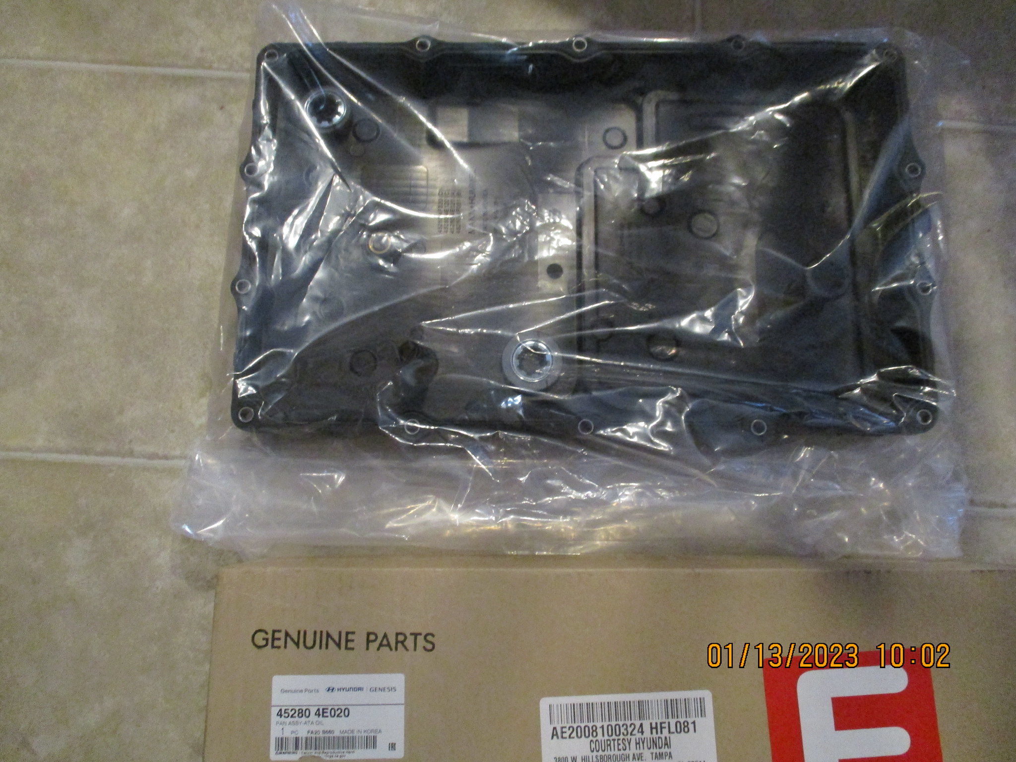

The mounting points line up with the old pan. The marking on the patient pending #s on the outside of the pan both match.

The mounting points line up with the old pan. The marking on the patient pending #s on the outside of the pan both match.;0
Cool. I was thinking that it should fit, but better safe than sorry.:)
Here's the verdict. The pan had a different size level tube insert and a extra inlet for the filter but it bolted right up. I switched the level tube from my old one. It comes off really easy. All I had to do is pitch it and it came right out.
I will check to see how my replacement transmission pan compares to the one you have.
My transmission pan is the same as the stock pan I believe with only one inlet. Part number 45280-4E020 even though it lists other part numbers on the pan as well. I will not know for sure until I swap pans.
My main concern would be the extra inlet tube preventing the pan from properly sitting flush on the transmission if it presses against the valve body.
I would try to return it for the proper transmission pan you ordered.
I got the pan on just fine. The car is shifting and driving like it should. Fingers crossed it holds up ha I'm gambling here. But that is how my stock pan looked when it came out.
