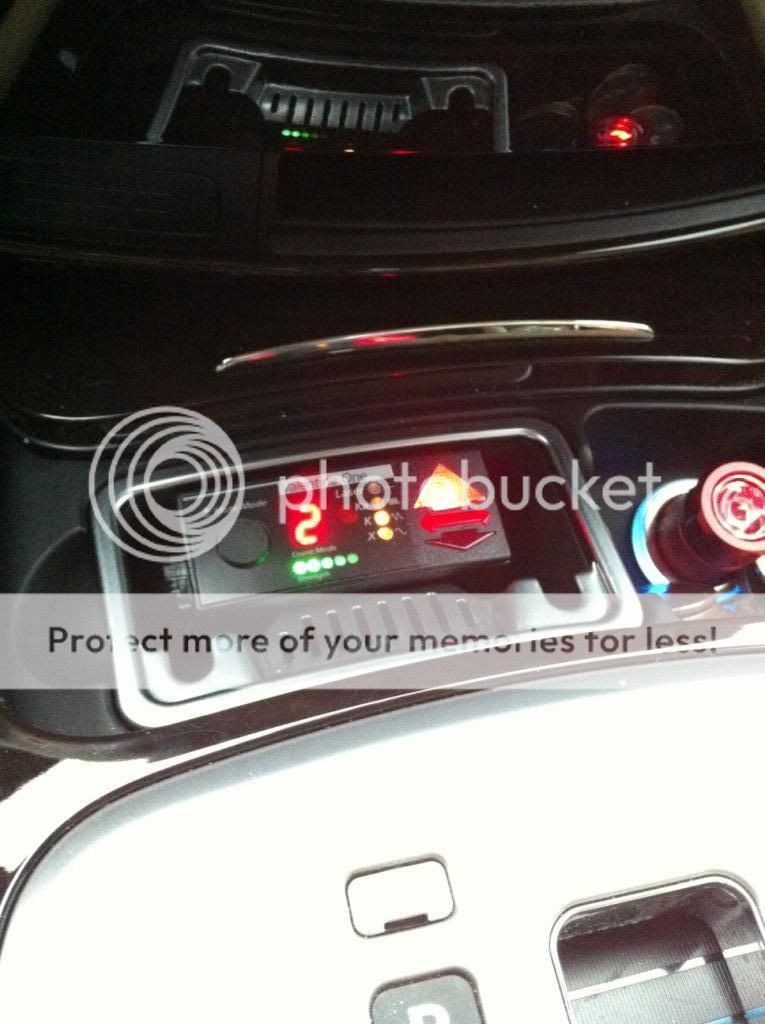

I thought a few individuals might be interested in a fairly stealthy install of a Valentine 1 radar detector. I really don't like radar detectors hanging off mirrors or windshields, mainly for aesthetic reasons and somewhere I read about someone installing one in the rear headrest. I decided to place the concealed display in the cigarette tray where the sliding cover can obscure it and to place the control unit in the center arm rest bin. With all of those closed nothing is visible.

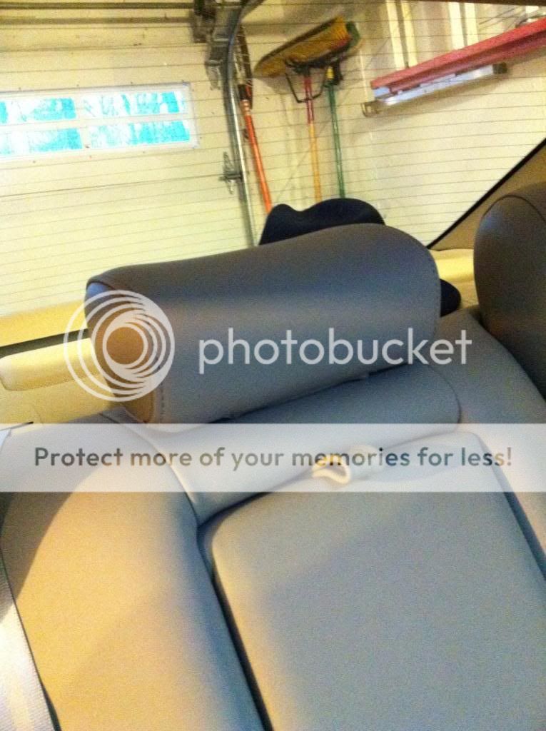

1. Remove the rear headrest. Using a large flat-bladed tool to push the black plastic “clip” (see photo) out, to open up the guts of the headrest. You don’t need to cut anything to get inside the headrest. Remove the plastic button on the side of the headrest. Remove the leather covering. Cut out the shape of the Valentine 1 in the foam and install the unit (see photos). Reassemble in reverse order. Replace headrest.

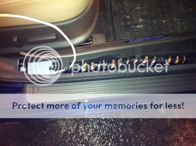

2. Run Cat 6 wire from headrest around car. Remove the plastic / fake chrome foot steps to get at the wiring channel that will allow feeding the wire down the side of the car. See photo.

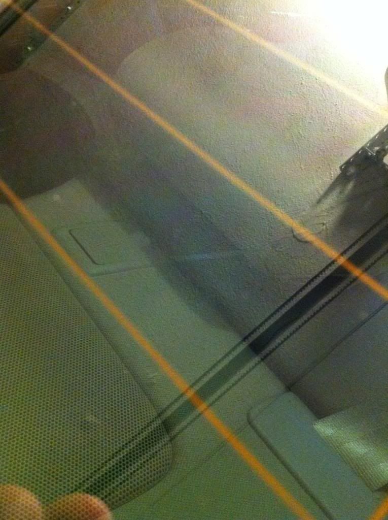

3. Tuck the wiring away out of sight where appropriate. This the wire as you see it through the rear window.
http://i1220.photobucket.com/albums/dd456/scbody/photo12.jpg

7. Drill a 3/16” hole on its left hand side of the cigarette tray. This is where the display unit will go when fitted. See photo.
8. Feed telephone cable through the holes according to the wiring diagram. Crimp RJ-11 plugs on the wiring. Add some black shrink tubing to the cat 6 wiring so it is less visible against the black background of the bin. See photo.
