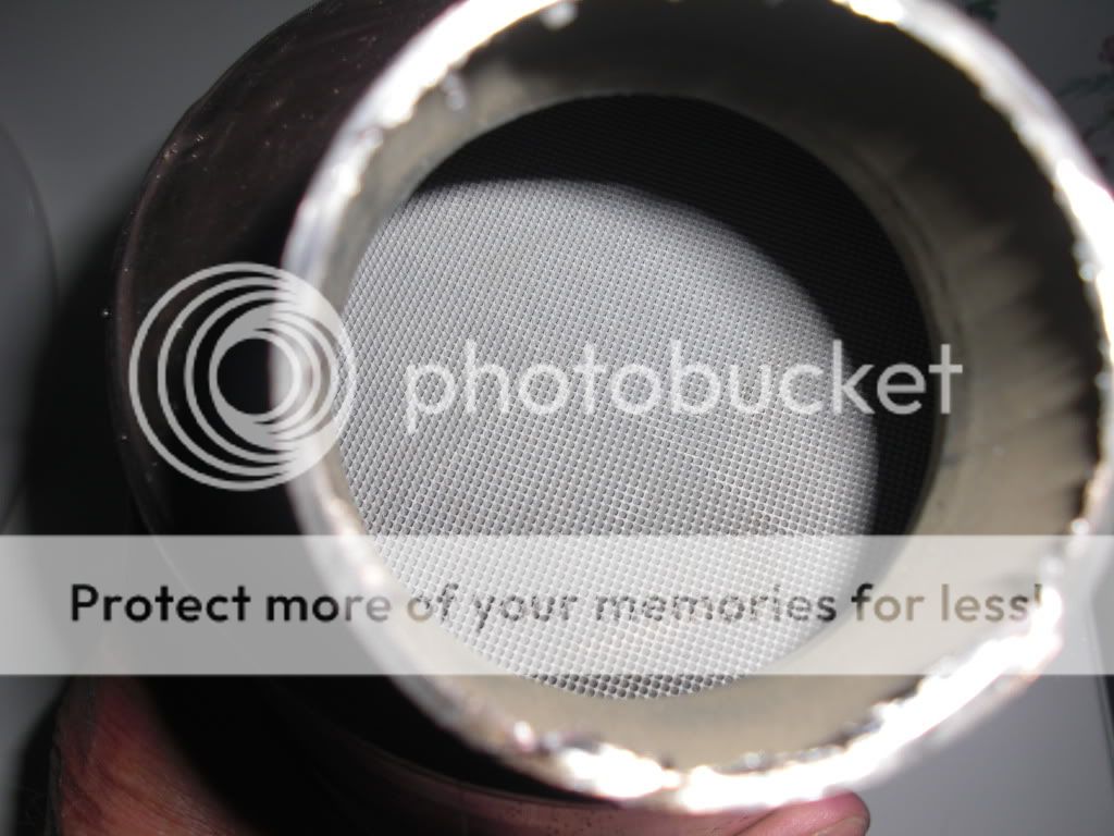

Way too quiet. I've got a 5.0, can't even hear it as shown in the above video. Below is a picture of a catalytic convertor cut out of a BMW 328i, an in line six with one of these per three cylinders. As one can see, I'm amazed an engine can run with these behind them. I cut these out and it made just the correct amount of difference, in my opinion. However, I'm in a state where if all the lights are out one passes inspection. Some states put sensors up the tail pipe. Don't think one will pass without the cats on. Regardless, I could never get my check engine light to go out. An outfit by the name of Riss Racing in CA, 714-850-0139, (I've tried calling them, no answer) was making what is called an oxygen simulator. It would be hooked into the engine ECU and make the computer think the cats were working properly. They never developed one for the 328i but had one for the 335i thus when I traded the car I had to put the cats back on.
Anyway, one could cut out the cats, more noise and HP. They do make hi-flow cats as well. One could also consider removing the big resonator behind the cats. One could also go with a cat back system. Regardless, I'm starting to think about trying something. I'm leaning towards resonator removal.

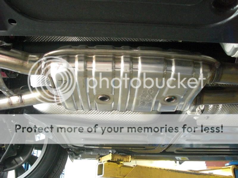

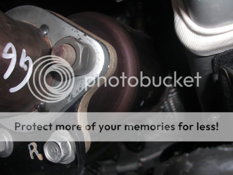

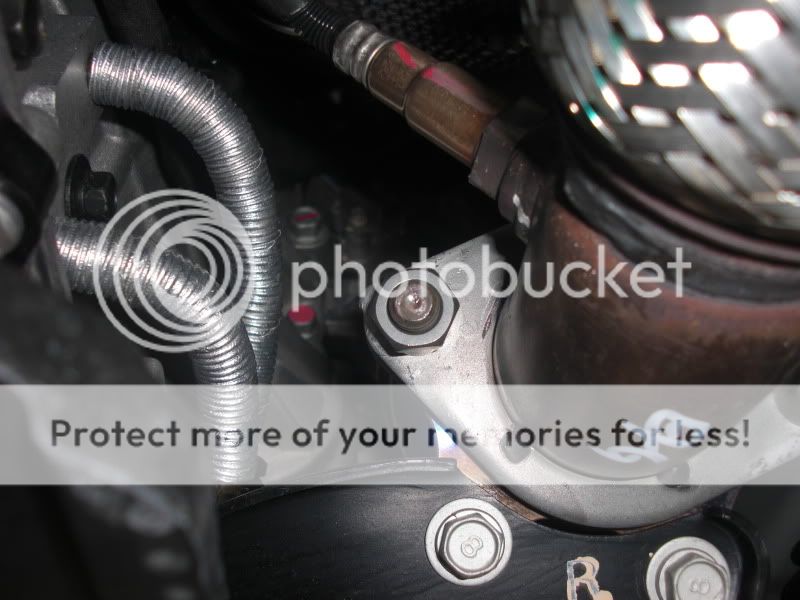

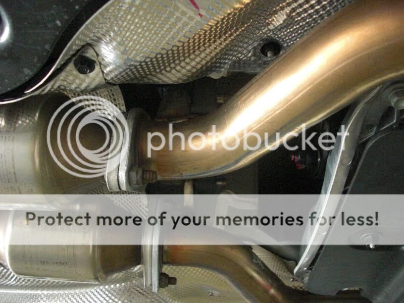

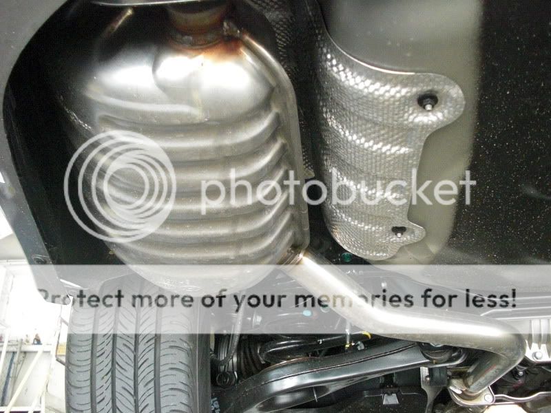

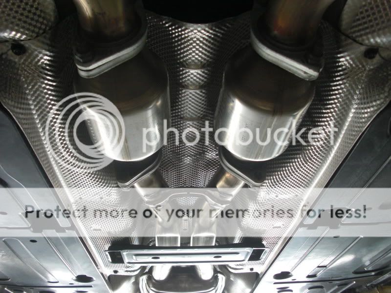

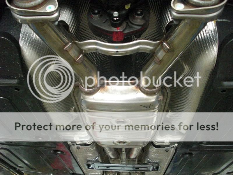

As we all know sound is subjective. If an exhaust system is properly done it sounds good and is not offensive to anyone. I've had several cars that, from the factory, had subdued and quality sound. It's not easy to replicate but I learned a lot today. My R Spec was on the lift so I took some pictures. The Catalytic converters are up below the exhaust manifolds. That's good news. The first picture is of the lower side of the cat. The second picture is of the oxygen sensor down stream of the cat. The third picture is of the two resonators which I mistook for cats while laying on my garage floor. One could have a shop weld a short piece of pipe with flanges and simply remove the resonators. If the sound wasn't right they could be easily re-installed. The same goes for the first muffler, and even perhaps for the second ones. Most of the pictures were taken from the right side of the car so the front of the car is to the right. Obviously this is the R Spec. I don't know what the exhaust system of the 4.8 looks like but I'd wager it's about the same?
As we all know sound is subjective. If an exhaust system is properly done it sounds good and is not offensive to anyone. I've had several cars that, from the factory, had subdued and quality sound. It's not easy to replicate but I learned a lot today. My R Spec was on the lift so I took some pictures. The Catalytic converters are up below the exhaust manifolds. That's good news. The first picture is of the lower side of the cat. The second picture is of the oxygen sensor down stream of the cat. The third picture is of the two resonators which I mistook for cats while laying on my garage floor. One could have a shop weld a short piece of pipe with flanges and simply remove the resonators. If the sound wasn't right they could be easily re-installed. The same goes for the first muffler, and even perhaps for the second ones. Most of the pictures were taken from the right side of the car so the front of the car is to the right. Obviously this is the R Spec. I don't know what the exhaust system of the 4.8 looks like but I'd wager it's about the same? I now know why our cars are so quiet. A resonator and two mufflers for each 4 cylinders. Regardless, since there are so many removable parts I'd bet be considerably cheaper to pay a shop to manufacture parts than install an entire cat back system
Taken facing back of car.
Facing front of car.
I've spent a lot of time modifying the 2009-2011 exhausts systems; and, in my opinion, the R-Spec exhaust appears to be identical to earlier exhausts.
The rear cats are redundant like those on the earlier models. There are no oxy sensors at these cats. Motor Sports Authority sells straight pipes to replace these cats at a reasonable price.
Further aft you will see huge dimples in the pipes to clear a cross member. This is overkill as there is plenty of clearance. A nice power increase can be obtained by cutting out these dimples and replacing them with straight pipes. Then just lower the cross member with a few washers.
The central resonator and rear muffler appear to be the same as earlier models.
Note, I say all this without measuring anything, but it does look identical to me. The only area they might have changed would have been to boost the pipe diameter aft the cats from 2.25" to 2.50".
Rey,
Thank you very much!!. So they are cats. The tech told me they were resonators. Regardless, I'll get up under my car and check out the diameter of the pipes. Obviously if they are different than what is offered they'll have to be made. Here is another picture of them. Perhaps you'd be able to tell by it if the diameter of the pipe has changed? Regardless, that website is excellent info.
Thanks again.
Skywagon,
I just looked at my spare rear cats from my 2009. In the 2009-11 rear cats the intake is 2.5" and outlet is 2.25". It looks to me, from your picture, as though the intake and outlet are the same diameter meaning 2.5".
