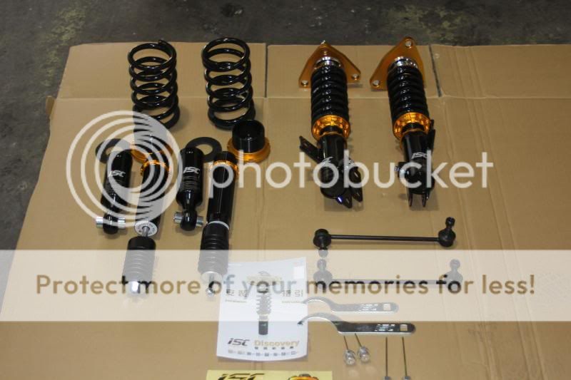

Spring Rate:
Since ISC lets you choose your own spring rates, I choose ISC standard Street Sport spring rate to start off since the car is my daily driver. I always have the option of choosing one of ISC’s “custom” spring rates in the future. This is a big advantage for me over some other coilovers.

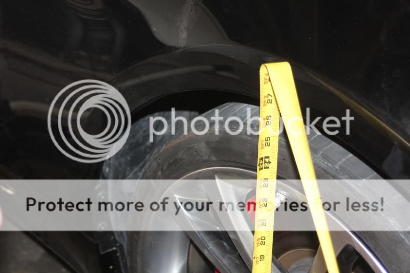

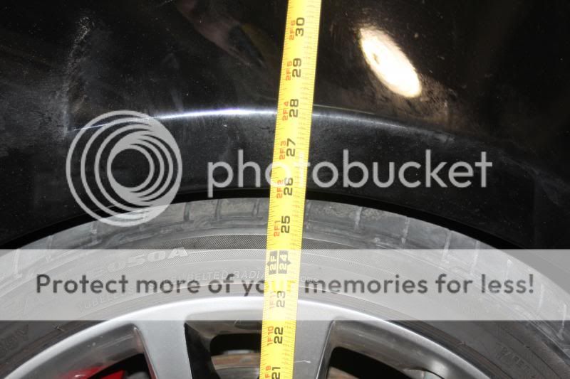

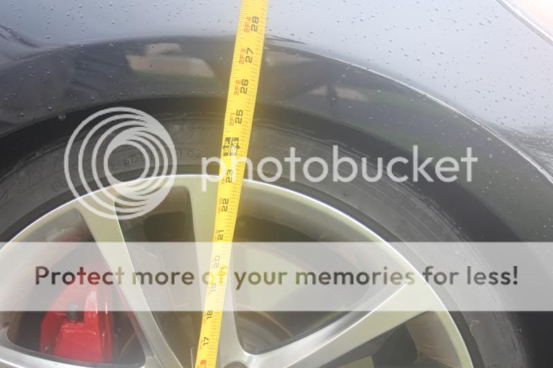

Before Pics: OEM
Rear Height:
Front Height:

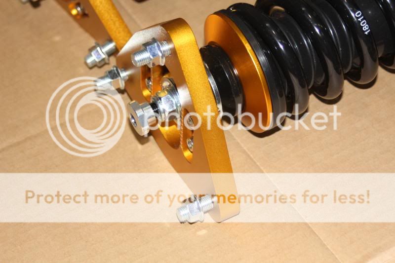

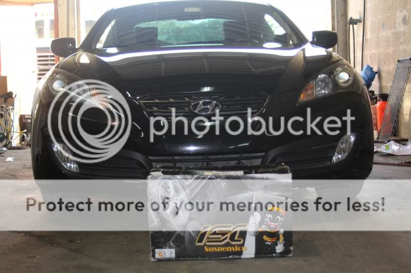

Setup:

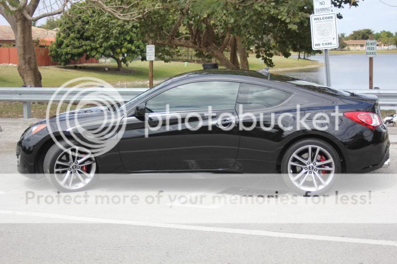

After Pics:
Rear Height:
Front Height:
