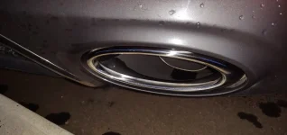

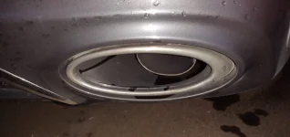

Not sure if this should be posted here or in the engine section.
The chrome piece near the exhaust tips has literally turned black... :eek:
Any suggestions on a wax or product to keep this clean?
Here is a random internet pic of the area I'm talking about
thank youView attachment 21277
I had a DIY on the G35 forum about how to clean these. It's carbon build up and it is common on GDI motors. Use alcohol-free Windex, steel wool, and then a mag/aluminum polish to buff the finish. It had never been done on the G35 and they were pitch black. Came out almost new. Doesn't hurt the finish. I do it every year or so on mine because it does build up often.
I'll have to try my Barkeeper's Friend, I have a bottle of their liquid (and powder), they do amazing work on stainless steel.
It is true though you if you clean them weekly it’s good and once you get them shiny keep up with them. Like flossing lol
I learned about the Magic Eraser / Mr. Clean Cleaning Pad trick from a detail shop. I've used them on my exhaust tips every since!
