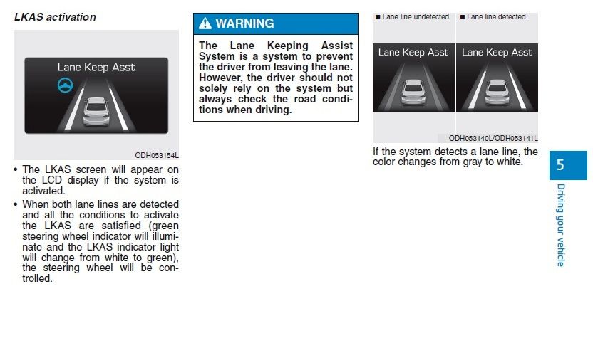

Is this the Steering Wheel your talking about?
Yes indeed. That is the steering wheel, and I have never ever seen that ikon on my display.
Thank you for the post of that page. I thought I had the settings right, but I rechecked it like you said, and I wasn't on predeparture in the lane keeping setup. I set it right and tried it and it now works. Thanks.
