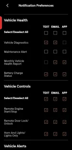

Like I stated above, you have to turn off maintenance reminders in your Connected Services app (see Maintenance Alerts in the attached screenshot). My maintenance reminders in my GV70 settings are set at the intervals I choose, 8000 miles and 12 months. My GV70 was just serviced in August (anniversary date). The intervals in my GV70 settings were reset. But I just got the service due alert the other week. Why? Because the Connected Services maintenance reminders are set at every 5000 miles and I'm approaching 15,000 miles. I turned off the maintenance reminders in my Connected Services app and the reminder pop-ups have stopped.Screenshot_20251011_113732_Genesis.webp

I don’t see that screen anywhere in my GV60 app. What’s it nested under?
From the main menu, click the menu hamburger in the lower right, and then Security and Privacy, and then Notification Preferences.
-Genesis app
-Select Menu at bottom right
-Select Settings & Privacy at top middle
-Select Notification Preferences toward the bottom
-Scroll down to Vehicle Health
-Deselect the Maintenance Alert options
