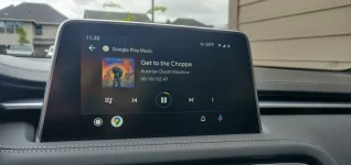

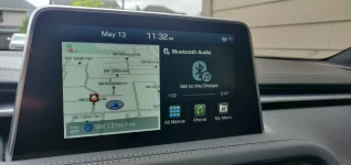

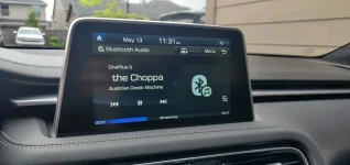

Is there album art for BT streaming?
Here is how it looks with Android auto...
And the same album with Bluetooth...
Evidently that is a firm no: no album art via Bluetooth.
I've never seen an Android be able to do album art via BT. Heard tales of iPhone doing it with some heads.... But I think it was through the Spotify app which is using a different API than Bluetooth alone.
It is the head unit itself. It’s running AVRCP 1.4 as far as I know. Looks like the firmware update didn’t update the AVRCP.
v1.6 is needs for Album Art over BT!
Cool. Didn't know that.
Oh boy... so, how do we get firmware for the head unit?
Should have been part of the update. Each update includes a newer version of Android. When we had access to the service menu, you could see the Android OS build date. Looks like they just didn’t touch the BT portion!
