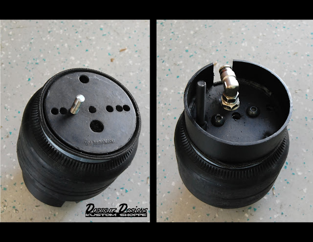

I have found Megan Coilovers to be perfect for a Bag over Coil set up.
Since Megan coilovers have an integrated top mount you can slip over an air bag in place of the spring.
Also the ride can be somewhat decent since it has adjustable damping.
232323232_fp5437%3A%3Enu%3D3265%3E568%3E%3A%3A6%3EWSNRCG%3D3865%3B85%3A7632%3Anu0mrj
232323232_fp73484%3Enu%3D3265%3E568%3E%3A%3A6%3EWSNRCG%3D3865%3B79%3A3%3B32%3Anu0mrj

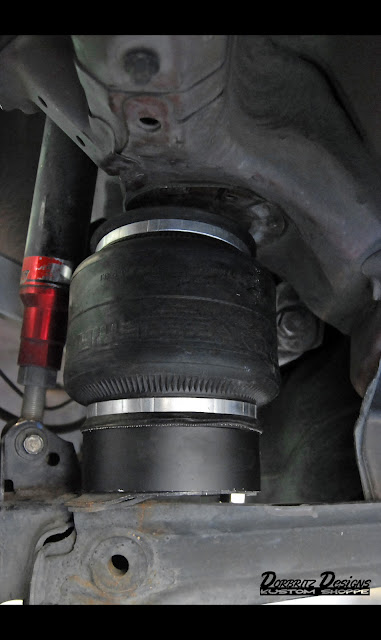

And using these threaded brackets from ForjWorks, the coilover can become this:
232323232_fp54383%3Enu%3D3265%3E568%3E%3A%3A6%3EWSNRCG%3D3865%3B7%3C35832%3Anu0mrj
232323232_fp543%3B%3A%3Enu%3D3265%3E568%3E%3A%3A6%3EWSNRCG%3D3865%3B8%3C24232%3Anu0mrj
232323232_fp543%3B3%3Enu%3D3265%3E568%3E%3A%3A6%3EWSNRCG%3D3865%3B7489532%3Anu0mrj

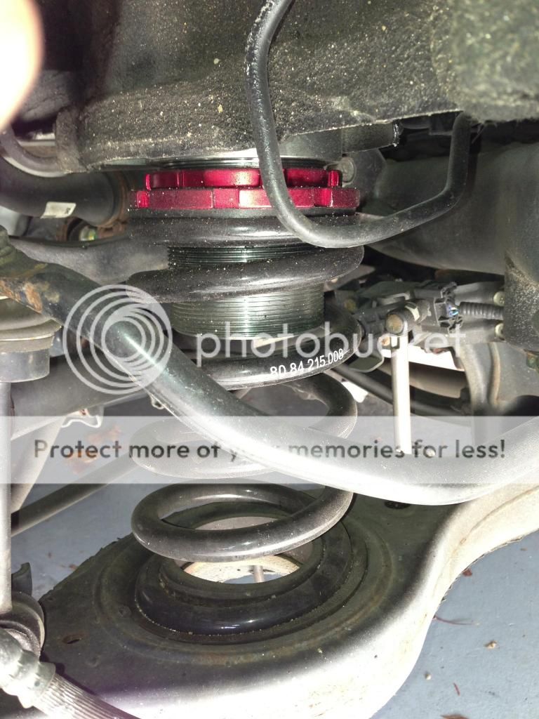

Can someone take a picture of the rear lower control arm where the spring should sit. And a pic where the spring is on the body. I want to see how brackets should be made so you can run the air line to the rear bag.

When I take my wheels off and put my stock ones back on and raise my car back up i'll take pictures.

Thanks for the pic of the rear control air. I think for a bag to fit there either the collar on the lower control air needs to be shaved off. From the bottom of the control arm, thread a bolt with a huge diameter washer to secure the bag to the control arm.
OR, instead of shaving the collar, make a bracket that makes the collar flush, then do the thread bolt and washer sandwich.
This is the idea, looking from the bottom of the control are, this will thread into the rear airbag.

Looking at how the rear springs sits in the lower control arm, the bracket can sit on the control arm and being creative with threaded bolts, secure the D-cup and airbag to the control arm.
Of course this is not a Genesis lower control arm, but just giving an idea of what might be possible.
I used d-cups systems for my sedan
our bolt on airsuspension uses D-cup systems as well. mine works fine and no cutting needed bolts right up and no problems so far.
