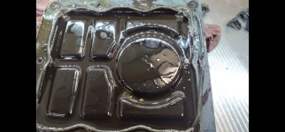

Metal shavings found in oil / oil pan.

I bought my 2015 3.8 used recently with about 45k miles on it. How can I make sure mine doesn't have metal shavings in the oil or oil pan? Should i ask the shop to check for that next time I get an oil change here in a couple of weeks?
The only way to tell if your oil pan have metal shavings would be to pull the lower oil pan and do a visual inspection. However, with your engine only having 45k miles of use I doubt that it would have any metal shavings if the engine is running well.

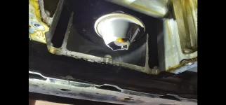

An oil test "should" will pick-up any minute wear metals suspended in the oil, but the best way to really tell if the engine is healthy is to pull the lower oil pan and also insect the oil pickup for debris like broken timing chain guide pieces.
