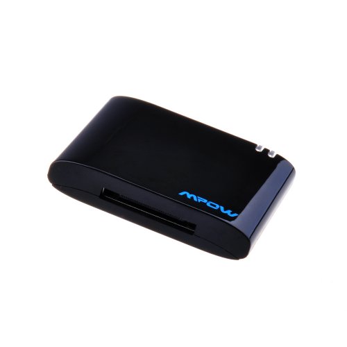

with one of these Bluetooth dongles:
I bought mine from Amazon for $15 shipped:
[ame="http://www.amazon.com/Bluetooth-Receiver-Adapter-Sounddock-Speaker/dp/B0094G44PS/ref=sr_1_1?ie=UTF8&qid=1385005373&sr=8-1&keywords=mpow+bluetooth"]Amazon.com: Mpow® Bluetooth A2DP Music Audio Receiver Adapter for Bose Sounddock and 30-Pin iPod iPhone Dock Speaker: Computers & Accessories[/ame]
When I first plugged it in the factory cable, the Genesis thought it was an iPod and tried to sync with it or whatever. I would be able to pair and play music briefly but then the Genesis would get frustrated with trying to sync with the adapter and would then cut out the music and tell me to try reconnecting.
I realized that the issue here is that the Genesis iPod cable includes data pins in the USB port. I still needed the USB port to supply power, but the data pins would have to go.
So, with a little help from a Dremel, I opened up the iPod cable end with the 3.5mm/USB connections and desoldered two of the USB wires from the conveniently labeled circuit board (leaving just the positive and negative wires intact), reinstalled the cover, and went back out to the car to give it a test.
And miracles of miracles, my phone pairs automatically in the first ~10 seconds, and I was able to play songs via BT with the Genesis thinking that I had only a 3.5mm cable plugged in. Borat voice: great success!
