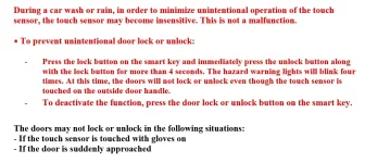

I don’t think it is locked. I am just getting out of the driver’s side and starting the car wash with the FOB in my pocket. But every time you go from front to back the mirrors are going in and out several times during the entirety of the wash. It is just doing the “auto-approach/prepare for entry” routine several times as the FOB gets out of range and back in range I believe.

My GV70 has a way to stop the locking/unlocking while washing the car manually under "Accessing Your Vehicle" in Chapter 5 Convenience Features. Check somewhere in your G90 manual for something similar.
