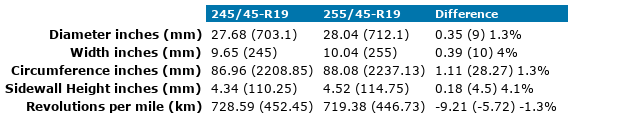

This site may answer some questions and concerns u may have about changing tire size.
Remember shifting points, performance n odometer readings can be effected by the diameter of the installed tires.
http://www.miata.net/garage/tirecalc.html
Going to a 245-45-19 from a 235-45-19 will change the revs per mile by less than 2%.
