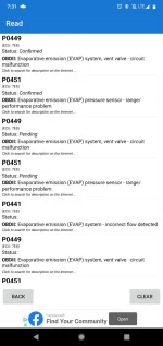

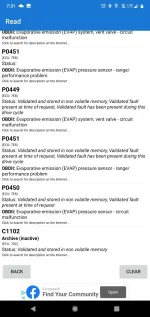

I attached some screenshots below of the CEL codes but if you cannot see the image they are:
P0449
P0451
P0441
P0450
C1102(inactive)
