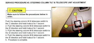

My 2009 3.8 sedan can not get steering wheel to adjust up down or in and out
I had similar issue. My steering wheel stuck in very low position and was going up and down like only half inch. I did reset procedure and it fixed. Try it. I attached screenshot image from TSB PDF file. PDF file also attached.

The control module for the steering wheel may need to be replaced even if the reset process works.

Thanks everyone
Thanks this was a help
Thanks for the feed back.
