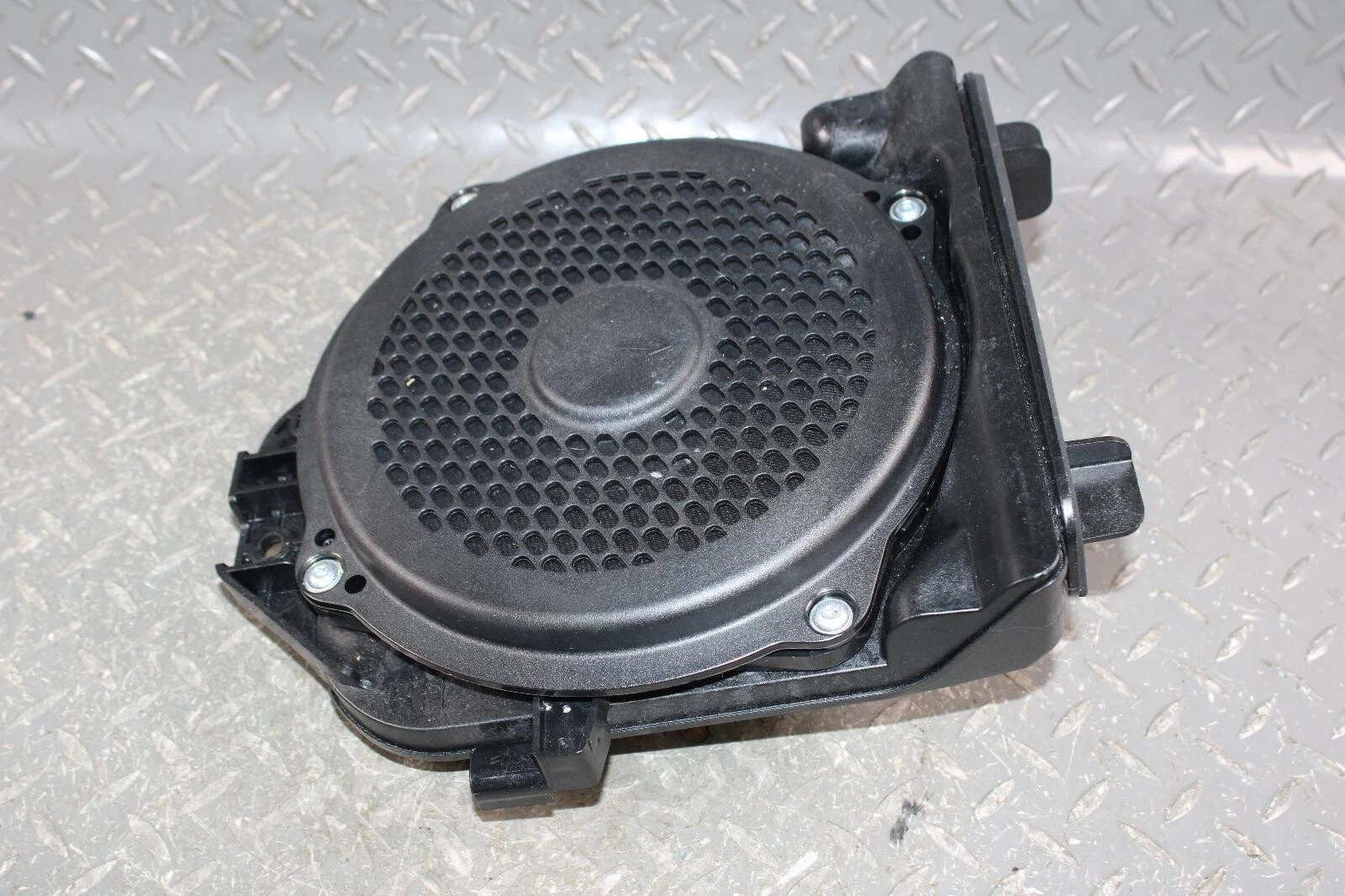

The 2 subwoofers under the seats are not subwoofers. They barely make any sound. I took it to the dealer yesterday, saying my subwoofers don’t work. That’s where they told me they’re not subwoofers!
I’m going to take it to an audio shop and see what they suggest. I’ll probably start with adding one subwoofer.

They are subs as I understand... What did the dealer tell you was under the seats?
However, no one know what the crossover is on them. Years ago someone on here tried to figure it out but I'm too lazy to search for those threads.
They are subwoofer, yes, but not very powerful ones, and they don't extend down very low either. There is just no beating physics. I bought a pair of them to install on my base model Stinger. These days, I'm not as willing to sacrifice trunk space, so these add some much needed low-end fill. That is the whole reason of being for these things. As long as you keep your expectation reasonable, they work as well as something as tiny as these things can muster. I would be very surprised if they have an enclosure volume of more than 0.1 cu.ft. each. The amount of voice coil excursion is probably tiny too, compared to aftermarket subs. Huge dynamics these will not make.
If you want better bass, you're gonna have to go aftermarket. That is the case with most cars in this class. I used to moonlight as a car audio installer back in college, and I have built countless number of subs. I know how good good can sound. By the same token, I know not to expect miracles. The OEM guys did a reasonable good job
Thank you for the picture and explanation. I’ll probably go with an under the seat sub I have a kicker sub in my Vette and it’s a game changer. I’m trying to avoid adding a separate amp for the sub.
