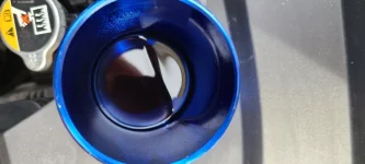

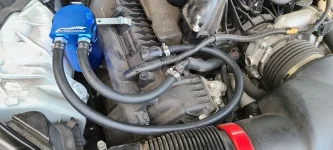

Ok...time to report on my OCC. I ordered a black one but all they had was blue and red, so I went with red to match the intake banding. It was an e-bay special that I think is the cheaper, non-branded version of the one the OP installed. I didn't really feel like bending metal tubing and went with the cheap rubber fuel hose method. The bracket is made with some cheap aluminum bar that I had from a previous project. I bent it with nothing more than 2 crescent wrenches. The little piece of foam between the bracket and OCC keeps it from vibrating around. There are 2 bolts holding down the cover over the ignition wires. I "borrowed" one of them to secure the can. It's an odd metric size and I still need to find a replacement to put back on the cover, but even with only 1 remaining it seems pretty secure.
I installed it about 1000 miles ago and just opened it to see what I had caught. I was both amazed and disgusted. Glad I caught this from going on the backside of my intake valves!!! So I can recommend this as a great weekend project that may extend the life of your motor and save you from an expensive cleaning on down the road.
