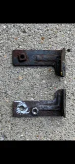

My 2015 Genesis 3.8 HTRAC requires 2 belly pans to be removed to change the oil. It is insanely complicated with the removal of the front pan that requires 8 plastic push pins (4 missing) at the bumper/fender liner and 5 rusty 10mm bolts. Two were rusted in and snapped.
The second belly pan that extends to nearly the rear axle needs to be removed to access the drain bolt. It has about ten 10mm rusty bolts. Several broken off prior to my ownership. The rusty bolts pictured were like this 2 years ago when I bought it with a couple already broken on a 3 year old car.

Next oil change, replace all bolts with stainless steel M6x1.00x20mm.
5 bolts for $1.27 at Lowe's. Will save lots of headaches and labor down the road.
You will need to clean out the rusted threads from all nuts.
I need to get a mechanic to drill out the one bolt that I can't get despite my best efforts.
There are 2 metal tabs that attach to the steering rack that hold a rusted weld nut.
I removed the brackets from the aluminum steering rack to dremel off the rusted weld nuts where one bolt was already snapped.
I took them to the weld shop and had stainless steel nuts welded in place ($3 labor each).
I used anti seize on the new stainless bolts especially on any that insert into rusted weld nuts that I have no access to cut off like on the steering rack tabs.
