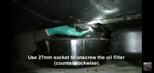

So I finally changed the oil on my 2019 G80 3.8.
Process was easy, I jacked up the left front side of the car using a 3 ton floor jack and put a jack stand next to the floor jack for safety. I was able to access the oil filter and drain plug with ease.
Not sure if it's okay for the car's frame to jack it up on one side to change the oil 20 times over the car's life, so I may buy some Rhino Ramps instead. I never liked getting under a car held by jacks and stands, anyway. At least I'm not in an earthquake prone area!
A simple socket set was used to remove and install everything, no issue there - easy access.
The oil drain plug faces rearwards on the car, so raising the front end might help with draining all the oil out. It uses a 17mm socket to access.
The two access panels were easy to remove and use a 10mm socket, but the rear one which accesses the oil drain plug also had two plastic snap-in panel joiner things that also had to be removed. Overkill if you ask me, but it is what it is. Just pry them open with a flat blade screwdriver and they pull out easily.
I made the mistake of buying 10 oil drain plug aluminum gaskets - I didn't realize that one comes with the WIX oil filter I had bought. So I'll never use those. The filter also comes with the rubber o-ring you need to replace on the oil filter cap.
My old drain pan only held 5 quarts, so I bought a new one that holds eight quarts. It's the Capri Tools CP21024, on Amazon for $20. It's easy when it comes to pouring the old oil out. This engine holds 7.3 quarts, it worked well. Plus, it's very convenient to have a second catch pan - one for the oil, and one for the filter.
I bought a 27mm socket to remove the oil cap to access the old cartridge filter. Bought the "Steelman 27mm Low Profile Oil Filter Wrench Socket" on Amazon for $10. It's well made. You could use a box or crescent wrench but it would not be nearly as easy. Plus, you're less likely to damage the cap by using a proper socket.
For oil, I used Pennzoil Platinum 5W-30 and the filter is a WIX WL10033. Got the oil at Walmart, bought three 5 quarts jugs - the 3.8 engine uses just under 1.5 jugs per change, so I kept half a jug which I'll use on my next oil change. Actually, the car seemed to use more like 7.25 quarts, so I may use the extra, left over oil to help flush the old stuff out on next oil change.
The WIX WL10033 oil filter was bought at RockAuto.com. They have good prices and fast shipping. I researched every filter available for this engine and the WIX is about as good as they get.
I noticed that the oil filter housing is made by Mahle, and that company also makes oil filters for this car. I overlooked them when searching for filters but will consider them in the future. I suspect the OEM filters are made by Mahle. One would think Mahle knows how to make filters for their own filter housing.
The only unusual part of this was replacing the new filter, o-ring, and cap onto the filter housing. It became tight sooner than expected as I was screwing it on, I was afraid I was cross-threading it. There were marks of white paint on the filter housing, one on the housing and one on the cap. Before I removed the cap I noticed the two white marks lined up. When replacing the cap I stopped tightening it when the marks lined up again and the cap was seated. I was glad to have that visual reference.
I was able to get all the old oil into empty jugs I had, filling empty space in old jugs used by two other cars. There's a Qwik Lube on my way to work where I can dump the old oil, so no issue there.
All in all, I would say that I can change the oil in the car in equal or better time that it would take two drive it to the dealer and have it done. I don't trust the Genesis valet pick up anyway, or the synthetic oil upcharge, so this works for me. Plus I kind of enjoy doing the work.
