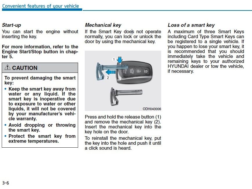

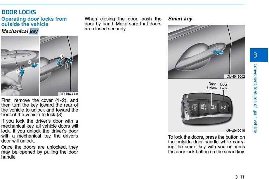

So where is the actual keyhole on the car anyway? Can't say I've ever looked for it or noticed where it is concealed.
I looked but couldn't find it (on the door anyway, the one on the trunk is easily visible and accessible as it should be). I'm assuming you have to pop off part of the handle covering on the driver door to access it. There's a small slot underneath the handle that is about the same size and shape as the key, but you can't just insert it.
Information from the manual - Hope this helps:
Mechanical key
If the Smart Key does not operate normally, you can lock or unlock the door by using the mechanical key.
Press and hold the release button (1) and remove the mechanical key (2).
Insert the mechanical key into the key hole on the door.
To reinstall the mechanical key, put the key into the hole and push it until a click sound is heard.

Here you have how to use mechanical key.
