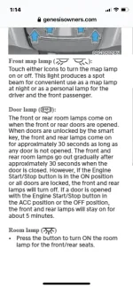

PMCErnie - I owe you a big apology.​
I did press the "door mode switch" this morning". But did not realize it was an on/off switch. Must have pressed it twice. Should have known better, it has an led to indicate on/off. Guess I was overwhelmed with all the tech I have been trying to absorb. No excuse, just an explanation.
Anyway - the description of the "door mode switch" in the owners manual is very confusing. A few minutes ago I read the following in the G80 Quick Reference Guide: When the Door Mode Switch is pushed, map lamp and rear room lamp turn on if any door is opened and will turn off after all doors are closed. Went to my car, pressed the switch (noted that the LED came on and now stays on). And Voila - works just fine.

👍👌 It’s the same as most vehicles have been for years. Actually, I believe it should be a three setting switch.
- Lights always on
- Lights always off
- Lights on when front doors open.

You could look in the manual. Easier if you download the PDF version.
