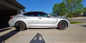

Plasti Dip Sapphire Black Metal with Glossifier. Think it turned out pretty good.
