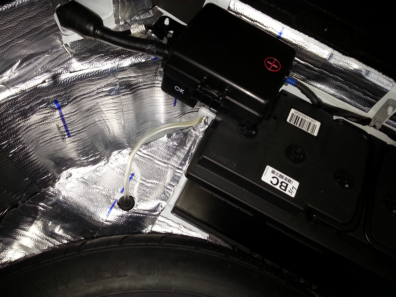

Here's mine:
Nice pix - but I didn't see all that heat shielding on mine
Factory dynamat - should be on there.

Just checked - mine is barebones metal base (in Montecito blue).
You said "factory dynamat"? You didn't add it?
No Dynamat on mine either. Is Srobat Canadian, I see he drives 3.8 and mine and Kn5owa are 5.0?
Maybe the exhaust/muffler routing on the 3.8 is why Srobat gets Dynamat.
Heat being a known battery killer.
I have a 5.0 AWD(Canadian Model) and no insulation, just bare metal.
Interesting. Coulda sworn it was factory. Guess not.
Maybe it is factory - but only on the V6's.
It looks good either way. And the way I figure it, a nice cool battery in the trunk oughta last forever. I was quoted $400 by the dealer for a replacement.
