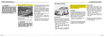

A search in an online 2014 Equus owners manual shows the button on the drivers door as having an AUTO setting to fold/unfold the mirrors automatically. A close-up of that switch says AUTO on the right side, and it sounds like it's switchable (Manual/AUTO ???). Check to see if that button is a left-right rocker switch.

pressing the lock on the fob once locks it, pressing it twice folds the mirrors in.
pressing the unlock on the fob once unlocks it (or just driver's door, adjustable in settings), pressing it a second time shortly after unfolds the mirrors.
the button on the driver's door is to fold/unfold the mirrors. i am not aware if it has an 'auto' function on 2014-2016 Equus' but it definitely doesn't on 2013 and previous
