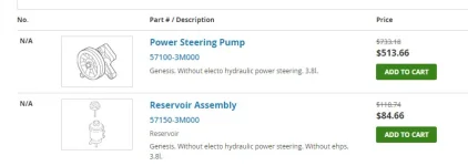

I noticed that the German made Pentosin power steering fluid CHF 202 is listed as a synthetic option on Carid.com. Has anyone used the Pentosin synthetic power steering fluid in their Genesis ?
Pentosin power steering fluid CHF 202 on sale at Amazon for around $14 now - this is for EHPS enabled models. The ones with cylindrical reservoirs are non-EHPS models.
