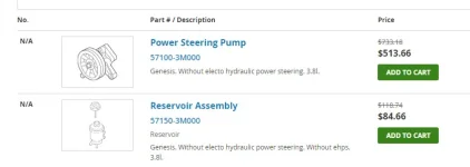

Changed the power steering fluid in my 2010 3.8 without EHPS last weekend. Other than a VIN check easiest way to tell if you have EHPS is the location and shape of your resevoir. If it is cylindrical and behing the radiator in the center you do not have it. If offset to passenger side to the left of the airbox and not cylindrical you do have EHPS. Could be different for 2011 through 2014, my FSM is for 2009 model.

I saw Pentosin on sale and thought about buying one today, glad I checked and yes - the reservoir should tell you easily what fluid to put in. round for non-EHPS models.

How does one find out if they have electronic PS? Mine is a 2012 3.8 with the premium package (not tech). Thanks!
From your owner's manual, it appears that you can tell via the location of the PS fluid reservoir.
