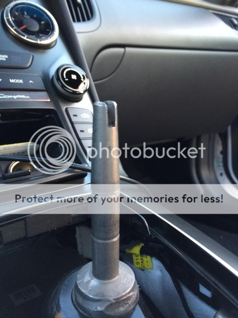

Hello everybody:
I have a 2014 genesis coupe 2.0T R-spec. Today I bought a shift knob that has M10x1.25 thread pitch, and I tried to replace my stock shift knob with the one I bought. But there was a problem I encountered when I took off the stock shift knob. Below is a picture.
Can you guys please help me out with finding out what I can do to use the new shift knob I bought?

2013 and up have press fit shift knobs you’ll have to buy aftermarket assembly to screw on a knob or just buy one that’s a press fit
I just replaced the shift knob on my 2015 on Monday, I ordered my new weighted shift knob from Billetworkz and it came with the adapter to screw the new one on.
